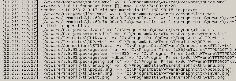

Происходит следующее: Из за двойного НАТа конфигуратор, хоть и отдаёт файлы по TFTP и HTTP, не видит терминала, т.е. для него он не в сети.
И, как мне думается, из за этого, не принимается пароль Setup`a в Тонком клиенте.
Это лечится?

20-58-48-688| [10.253.210.2] '/wtware/5.8.91\packages\kernel' => 'C:\Program Files (x86)\WTware\TFTPDROOT\5.8.91\packages\kernel'.
20-59-03-919| [10.253.210.2] WTware v.5.8.91 found at host [], mac 14:DD:A9:E1:37:E8.
20-59-03-919| [10.253.210.2] Sender IP did not match ip=192.168.99.18 in packet.
20-59-03-919| [10.253.210.2] '/wtware/5.8.91\packages\lib6' => 'C:\Program Files (x86)\WTware\TFTPDROOT\5.8.91\packages\lib6'.
20-59-13-099| [10.253.210.2] '/wtware/Everyone\source.wtc' => 'C:\ProgramData\WTware\Everyone\source.wtc'.
20-59-13-439| [10.253.210.2] WTware v.5.8.91 found at host [], mac 14:DD:A9:E1:37:E8.
20-59-13-439| [10.253.210.2] Sender IP did not match ip=192.168.99.18 in packet.
20-59-13-439| [10.253.210.2] '/wtware/Everyone\list.wtc' => 'C:\ProgramData\WTware\Everyone\list.wtc'.
20-59-13-455| [10.253.210.2] '/wtware/Terminals\14.DD.A9.E1.37.E8\config.wtc' => 'C:\ProgramData\WTware\Terminals\14.DD.A9.E1.37.E8\config.wtc'.
20-59-13-472| [10.253.210.2] '/wtware/Terminals\14.DD.A9.E1.37.E8\wtware.lic' => 'C:\ProgramData\WTware\Terminals\14.DD.A9.E1.37.E8\wtware.lic'.
20-59-13-472| [10.253.210.2] Failed to open file.
20-59-13-487| [10.253.210.2] '/wtware/Everyone\all.wtc' => 'C:\ProgramData\WTware\Everyone\all.wtc'.
20-59-13-503| [10.253.210.2] '/wtware/Everyone\wtware.lic' => 'C:\ProgramData\WTware\Everyone\wtware.lic'.
20-59-13-833| [10.253.210.2] '/wtware/Templates\CLID.wtc' => 'C:\ProgramData\WTware\Templates\CLID.wtc'.
20-59-13-833| [10.253.210.2] '/wtware/Templates\RDP.wtc' => 'C:\ProgramData\WTware\Templates\RDP.wtc'.
20-59-13-849| [10.253.210.2] '/wtware/Connections\ST22.wtc' => 'C:\ProgramData\WTware\Connections\ST22.wtc'.
20-59-13-943| [10.253.210.2] '/wtware/5.8.91\packages\f' => 'C:\Program Files (x86)\WTware\TFTPDROOT\5.8.91\packages\f'.
20-59-15-751| [10.253.210.2] '/wtware/5.8.91\packages\fwt6' => 'C:\Program Files (x86)\WTware\TFTPDROOT\5.8.91\packages\fwt6'.
20-59-18-840| [10.253.210.2] '/wtware/5.8.91\packages\f-i915' => 'C:\Program Files (x86)\WTware\TFTPDROOT\5.8.91\packages\f-i915'.
20-59-21-378| [10.253.210.2] '/wtware/5.8.91\packages\graphic' => 'C:\Program Files (x86)\WTware\TFTPDROOT\5.8.91\packages\graphic'.

Тогда другой вопрос: Почему в конфигураторе клиента не видно совсем? Только в логах TFTP и HTTP.
Re: Короновирус
Потому что "Sender IP did not match ip=192.168.99.18 in packet". Когда писали, не придумали, почему такое может случиться, и решили на всякий случай не пущать.
Попробуй это: http://wtware.com/testing/202004011250.zip
На клиента нет необходимости ставить. Надо поставить на сервер, чтоб TFTP и HTTP новые встали.

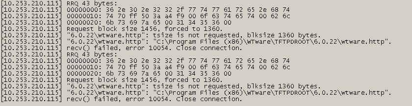

Прошло полгода. Понадобилось опять запустить это.
И не могу понять что не нравится TFTP-серверу

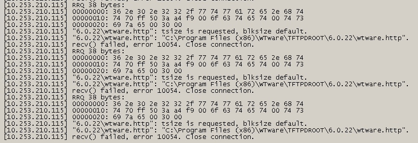

Re: Короновирус
Сообщение amxs3 »
Через другой интернет сообщение немного поменялось.
Это случайно не про MTU оно говорит?
Re: Короновирус
Оно говорит: "Перемудрили с настройками сетей. Уберите то, чего не понимаете."
В соседней теме тот же код ошибки 10054 был, и вылечилось MTU: https://forum.wtware.ru/viewtopic.php?t=25944
amxs3
Сообщения: 186
Re: Короновирус
Сообщение amxs3 »
Да, спс. Это был Мегафонный инет. Через нормальный нормально заработало.
